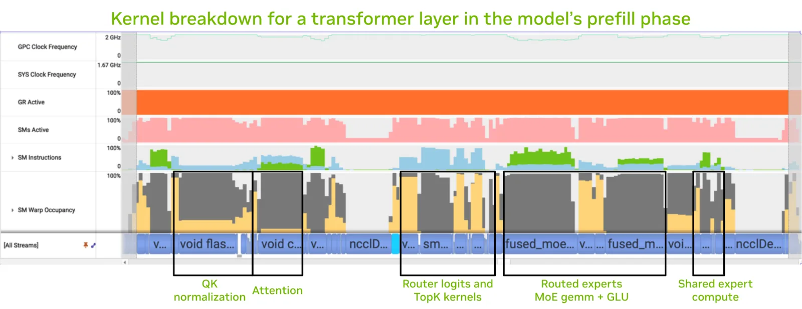

模拟数据表明,32 至 64 个请求的并发范围较有可能满足 SLA 要求。为确定在此并发范围内限制 token 吞吐量的具体瓶颈,NVIDIA 与 Sarvam AI 团队采用 NVIDIA Nsight Systems,以 32 个并发请求的形式捕获预填充和解码阶段的执行追踪。随后,我们对追踪数据进行处理,以提取单个 Transformer 层中每个内核的微秒级延迟贡献。
分析结果显示,尽管计算密集型的通用矩阵乘法(GEMM)运算(专家和注意力部分)表现良好,但在非计算密集型操作中仍存在显著的延迟气泡,尤其是在 MoE 路由逻辑和位置嵌入计算环节。这些操作面临内核启动开销大以及内存读取冗余的问题。
A diagram showing the Nsight Systems profiler timeline for a single transformer layer during the model’s prefill phase. The horizontal axis shows time, and stacked rows display GPU metrics including GPC and system clock frequency, GPU active time, streaming multiprocessor (SM) active percentage, SM instructions, and SM warp occupancy. Along the bottom, a sequence of GPU kernel launches is visible. Several regions are outlined with red boxes to highlight the most time-consuming operations: Query and key (QK) normalization and rotary positional embedding (RoPE), attention computation, router logits with top-K selection, routed MoE expert GEMM plus gated linear unit (GLU), and a shared expert GEMM plus GLU. The visualization emphasizes how GPU compute and occupancy vary across these kernels within one transformer layer.
图 1. Nsys 分析器时间轴显示 SM 活动和核函数在预填充阶段的执行情况,红色方框标记层中耗时最多的核函数:QK 归一化、注意力和 MoE 专家计算。

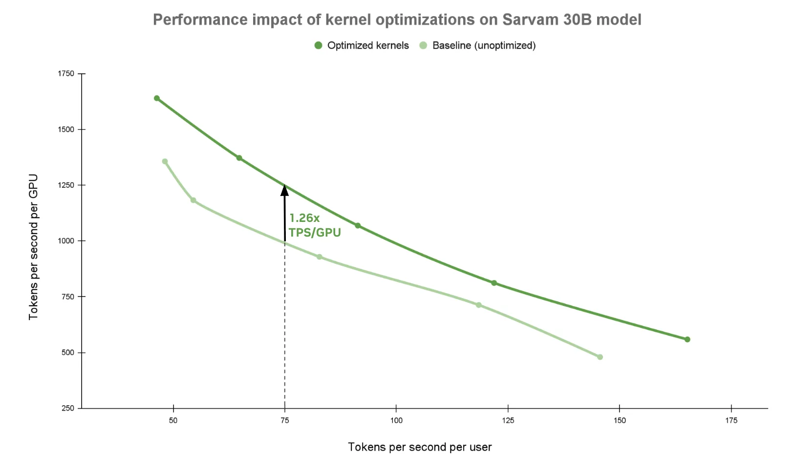

这些有针对性的内核优化将预填充阶段每个 Transformer 层的总处理时间从 3.4 毫秒缩短至 2.5 毫秒,相比基准 H100 性能提升了 1.3 倍。延迟的降低直接带来了更高的并发支持能力,使我们能够在每个 GPU 上为更多用户提供服务,同时仍将首个 token 延迟(TTFT)以及约 15 毫秒的 token 间延迟(ITL SLA)严格控制在 1000 毫秒以内,如图 2 所示。
Line chart titled “Performance impact of kernel optimizations on Sarvam 30B model.” The x-axis shows tokens per second per user, and the y-axis shows tokens per second per GPU. Two lines compare performance: a green line for optimized kernels and a lighter green line for baseline (unoptimized). Across all concurrency points, the optimized line remains above the baseline line, indicating higher throughput per GPU. At 75 tokens per second per user, the optimized configuration reaches about 1,255 TPS per GPU compared to about 998 TPS per GPU for baseline, marked with dashed guide lines and an annotation indicating a 1.26× improvement. As tokens per second per user increase, both lines slope downward, but the optimized kernels consistently deliver higher throughput than the baseline.
图 2. 通过在不同并发点进行内核优化实现性能提升。重点关注每用户 75 TPS 时的性能表现,经内核优化后,每个 GPU 的整体 token 吞吐量提升了 1.26 倍。

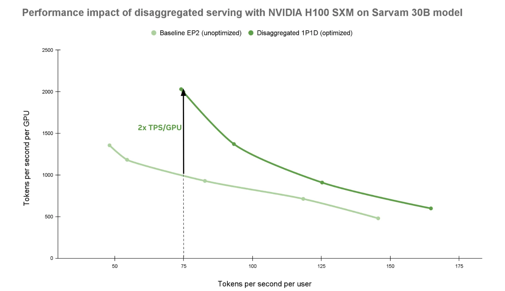

尽管改进了内核和调度,但我们的分析表明,token 分布(专家并行)的 GPU 间通信仍处于关键路径上。由于 Sarvam 30B 模型(通过 FP8 精度进行优化)可轻松适配单个 NVIDIA H100 SXM GPU 的显存,我们决定从模型并行转向分解服务。
我们重新配置了设置,通过 SGLang 路由器采用 1P+1D 策略:将一个 NVIDIA H100 SXM GPU 专门用于预填充,另一个用于解码。该方法消除了前向传递过程中在 GPU 之间路由 tokens 的开销。效果立竿见影:TTFT 显著降低(得益于预填充工作进程持续运行),同时每位用户的解码吞吐量大幅提升(较基准 H100 性能高出 1.5 倍),表明对于此模型规模,工作流分离的优势已超越聚合内存容量的收益。
Line chart titled “Performance impact of disaggregated serving with NVIDIA H100 SXM GPUs on Sarvam 30B model.” The x-axis shows tokens per second per user, and the y-axis shows tokens per second per GPU. Two lines are plotted: a light green for baseline aggregate EP2 configuration (unoptimized), an orange line for optimized aggregate EP2 configuration, and a green line for disaggregated 1P+1D optimized configuration. Across all user throughput points, the disaggregated configuration delivers the highest tokens per second per GPU, followed by the optimized aggregate configuration, with the baseline lowest. At 75 tokens per second per user, annotations show approximately 998 TPS/GPU for baseline, and about 1,995 TPS/GPU for disaggregated serving, highlighted with arrows indicating roughly a 2x× improvement over baseline.
图 4. 在 NVIDIA H100 SXM 上部署服务对 Sarvam 30B 模型的优势

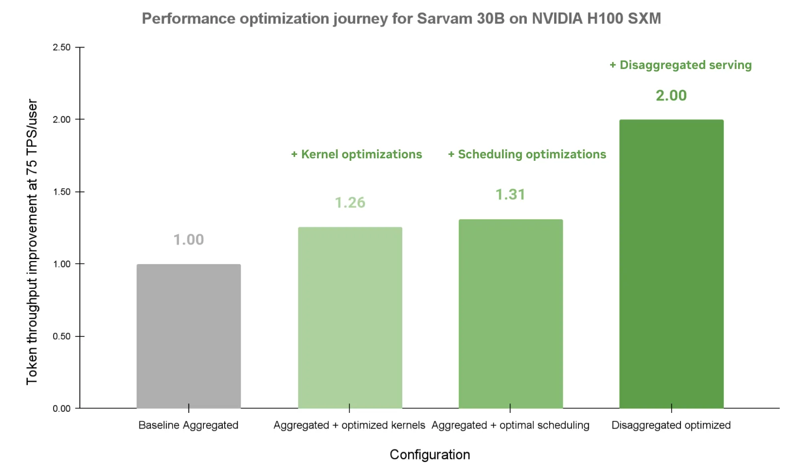

下图 5 总结了我们通过结合使用优化内核和调度优化所实现的端到端性能加速效果。我们还发现,针对该模型和 ISL/ OSL 工作负载模式,以及特定的 TTFT 和 ITL SLA 要求,解服务是较为理想的配置方案。
Bar chart titled “Performance optimization journey for Sarvam 30B on NVIDIA H100 SXM.” The y-axis shows token throughput ratio at 75 tokens per second per user, and the x-axis lists serving configurations. Three green bars show increasing performance with a gray bar as the baseline: “Baseline aggregated serving” at 1.00, “aggregated serving + optimized kernels” at 1.26 with notes about MoE GEMM shape tuning, router kernel optimization, fused normalization with RoPE, and shared expert overlap, “aggregated serving + optimal scheduling” at 1.31 with optimized kernels and mixed prefill and decode chunking, and “Disaggregated optimized” at 2.00 labeled as disaggregated prefill and decode (1P+1D configuration) with optimized kernels. The chart illustrates steady gains in throughput as kernel optimizations, scheduling improvements, and disaggregated serving are applied.
图 5. 通过结合内核优化、调度优化与分解服务,在 NVIDIA H100 SXM 上实现了 Sarvam 30B 模型推理的逐步改进。

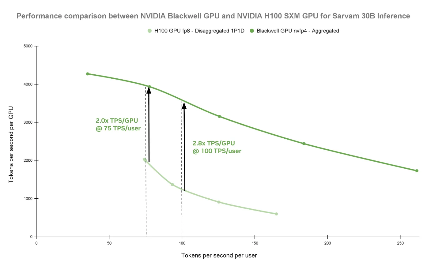

NVIDIA Blackwell 架构旨在加速生成式 AI。NVIDIA Blackwell GPU 可提供高达 20 PFLOPS 的 FP4 峰值计算能力和 8 TB/s 的显存带宽,性能超越 NVIDIA H100 GPU。这一吞吐量由第二代 Transformer 引擎驱动,该引擎采用全新的 NVFP4 格式,在保持高模型精度的同时,性能较 FP8 提升逾两倍。
为了利用 Sarvam 模型中的这些功能,我们采用 NVIDIA Model Optimizer 将基础 BF16 模型量化为 NVFP4 格式。与需多个 H100 GPU 的配置不同,NVIDIA HGX B200 仅使用一块 Blackwell GPU 即可高效地为 Sarvam 30B 模型提供服务。通过结合模型的内核与调度优化以及 NVIDIA Blackwell 的 NVFP4 计算吞吐能力,我们实现了推理服务吞吐量 4 倍的提升,达到每个用户操作点每秒 75 个 tokens 的处理速度。
如下图 6 所示,NVIDIA Blackwell GPU 凭借其卓越的计算能力,在低延迟条件下实现高性能,并依托显存容量优势,在高并发场景下展现出优异的吞吐能力。
Line chart titled “Performance comparison between NVIDIA B200 and NVIDIA H100 SXM for Sarvam 30B inference.” The x-axis shows tokens per second per user, and the y-axis shows tokens per second per GPU. Two lines are plotted: a green line for NVIDIA B200 (nvfp4, aggregate 1 GPU) and a light green line for NVIDIA H100 SXM (fp8, disaggregated 1P+1D). Across all operating points, the B200 line is significantly higher than the H100 line, indicating greater throughput per GPU. At 100 tokens per second per user, annotations show approximately 3,571 TPS per GPU for B200 versus about 1,274 TPS per GPU for H100, with an arrow highlighting roughly a 2.8x throughput advantage for B200. At the 75 tokens per second per user operating point, the B200 still maintains a 2x advantage over H100.
图 6. 与 NVIDIA H100 SXM GPU 相比,NVIDIA Blackwell GPU 在 100 TPS/用户操作点下,可将 token 吞吐量提升 2.8 倍。
