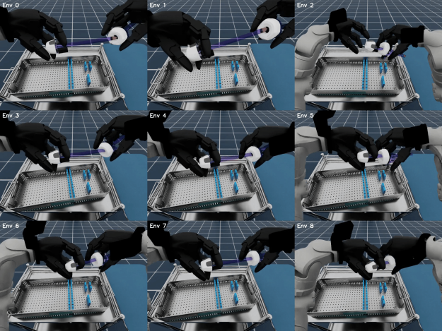

对于精确的多阶段双手操作 (如 Assemble Trocar ) ,Rheo 使用聚焦 Isaac Lab 轨道 ,其中 OR 生明确定义为场景配置:机器人、摄像头、USD 场景、物体和照明。
@configclass
class AssembleTrocarSceneCfg(InteractiveSceneCfg):
    """Scene configuration for the assemble_trocar task."""
    robot: ArticulationCfg = G1RobotPresets.g1_29dof_dex3_base_fix(...)
    front_camera = CameraPresets.g1_front_camera(...)
    left_wrist_camera = CameraPresets.left_dex3_wrist_camera(...)
    right_wrist_camera = CameraPresets.right_dex3_wrist_camera(...)
    scene = AssetBaseCfg(..., spawn=UsdFileCfg(usd_path="..."))
    trocar_1 = RigidObjectCfg(..., spawn=UsdFileCfg(usd_path="..."), init_state=...)
    trocar_2 = RigidObjectCfg(..., spawn=UsdFileCfg(usd_path="..."), init_state=...)
    tray = ArticulationCfg(..., spawn=UsdFileCfg(usd_path="..."), init_state=..., actuators={})
   light = AssetBaseCfg(..., spawn=sim_utils.DomeLightCfg(...))
在 Isaac Lab 中评估 Trocar 组件
